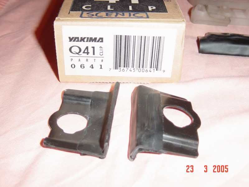

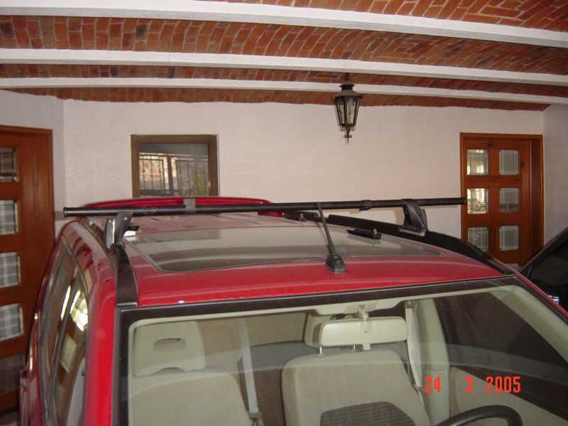

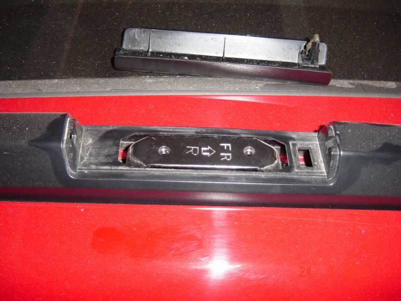

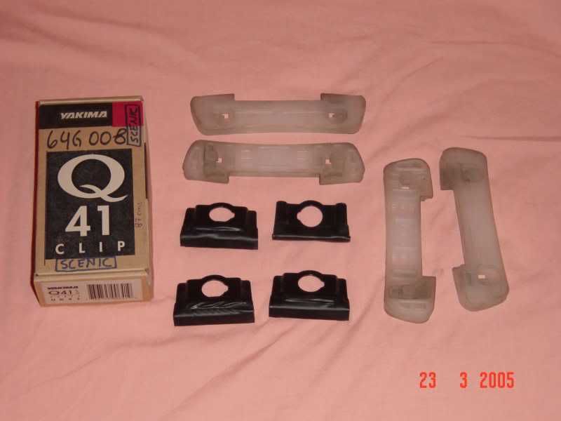

Clips:
Remove the covers:

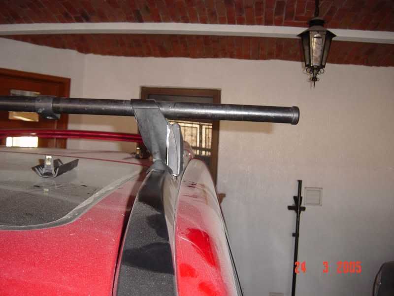

Q-Tower, Round Bars & Q41 clips: *
I just put the front bar for pic purposes:
Another View:
_______________________________________________________________
*Rack Fitment is a little bit different than with other cars, cause you have to fit the Yakima clips inside the X-Ty piece, then fit the tower at the clip, this is because there's no space fot turning the Yakima Clip, I guess this is the way to go with this clips 'cause I've done the same to fit the rack above my Renault's Scenic Roof.

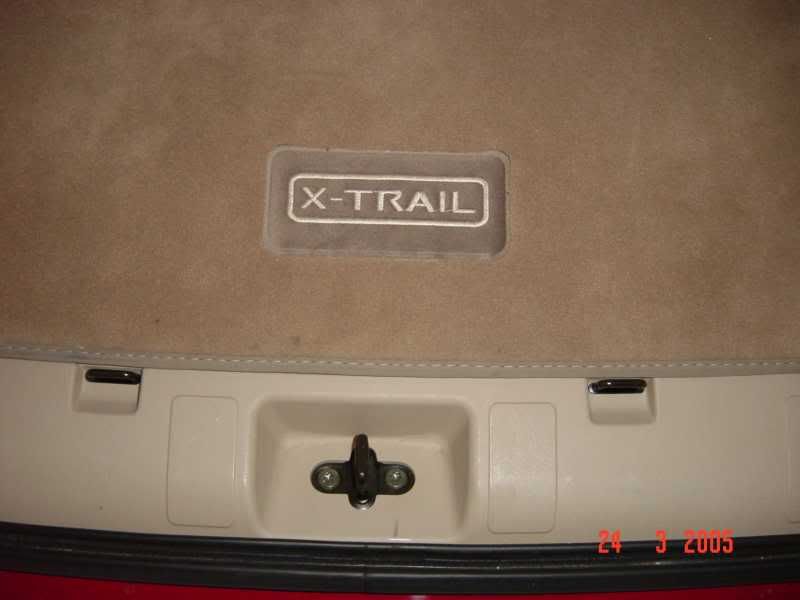

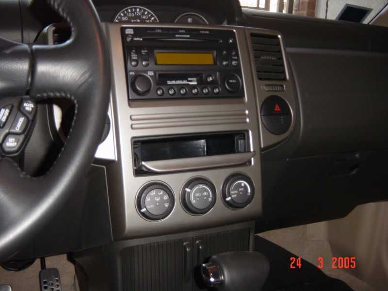

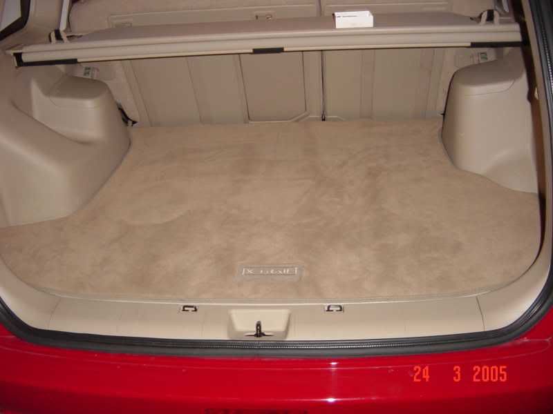

I owe some pics:
The under-radio cover opened:
Rear Rug Mat:

ViperZ said:
Excellent Pictures Manuelga :thumbup: So those black Q-Clips with the rubbers slip underneath the Nissan mounts (3rd picture)?
I like the door on the covey hole :)
Exactly, the Q-clips slide between the plastic & metal part of the X-Ty, it fits & tights really strong.
I've to check if the covey hole could be a separate part or came with the whole central silver'esque cover.
417 Posts
aussietrail said:
Hi Manuel,
Luv the colour of your interior :thumbup:
I wish mine was the same colour isntead of the boring grey.
A Tan interiour in a black XTy would look awesome :) Tan goes well with Red, Black, not so good in Silver :) I actually wish the rest of my interiour was dark gery/black like my seats, the plastic would not show marks ore dirt scuffs as readily.
27 Posts
trunk carpet and trailer hitch
Speaking of carpets, I will be getting one free of charge from my dealer. :thumbup: I was at the and had mentioned how disappointed I was about the install of my trailer hitch, which was a little off center at the time of install. They said they used the template provided to them by Nissan to make a cut in the bumper to fit, this template they say is off center. To make it look center they ended up cutting the hole bigger, I was not to pleased about this and let them know it. I mentioned how I found it annoying how things slid around back in the trunk area and they ended up offering me a free trunk mat. I am not one to turn free stuff done so I took them up on it. :) Actually wasn't really expecting anything from them at all, so that was cool. Anyone else have a hitch installed by a dealer that was off center?

39 Posts
I spent some time on the phone with Rack Attack, and they took a look at your pics, Mauelga. I was disappointed to hear from them that Yakima would not warranty their product like that. I don't know why since it's all Yakima product, but they said that Yakima wouldn't and that they would not recommend it. I think I'm stuck having to buy Nissan crossbars...

Discussion Starter · #20 ·
It's a shame the lack of customer service of Yakima's employees.
It's way much stronger at X-Trail with those clips that at my Sentra with their specific clips due to weaker roof, (it also apply to my Father's Altima).
If they don't want your business, try Thule Racks, they are focused on European Market/Cars & I guess they could have an specific fit (try UK rack pages).
The advantage of Universal, "just-change-clips Racks" is that you can switch to another car, for just a clip investment.
