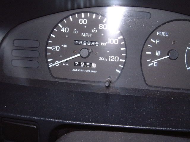

Well, it took several hours yesterday but mission accomplished!
BTW: In case anyone was wondering the gauge cluster from a B14 is an exact direct fit into a B13 (just a lot of rewirinig (splicing and sodering) on the back end to make it work)
Some people said it couldn't be done but here are the photos to prove it:
Here is what was in the 200sx SE-R:
...and here is what was in the 94 Sentra E:

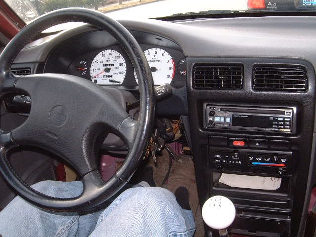

...and NOW:

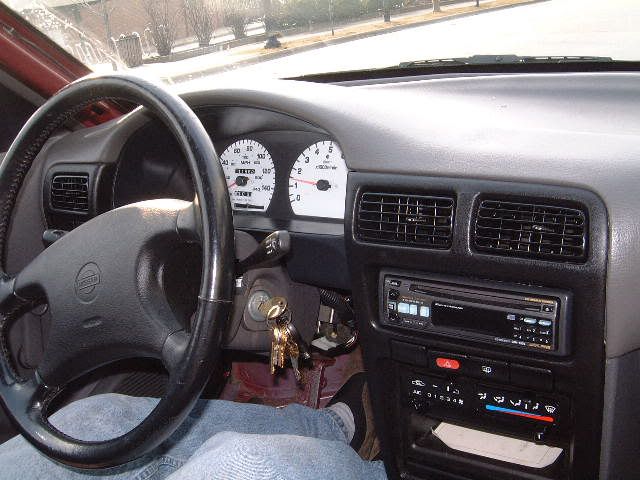

..yes it really is in the 94 E now:
..oh, and added touch of white shift knob to match (very nice round ball -- old skool)

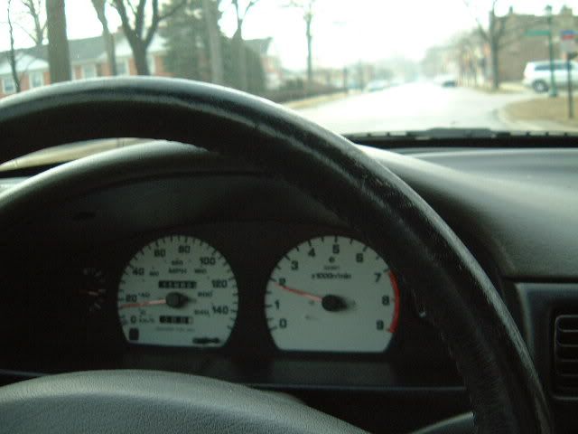

so is the tach accurate? looks like you're idling at 1500rpm.
Yes, it is 100% accurate.. and the photo showing the 1500 RPM was taken while in gear moving down a side street by the passenger (not the driver). ..and another while in the process of parking on a side street (still in gear).
BTW: It isn't all that unusual to idle high 1st thing in the morning on a below 30 degree morning before the car warms up..

The entire cluster is a direct fit into the B13 (no modifications of any kind to the dash or gauge surround piece).. the modifications necessary are at the back of the unit.. you need to have the wiring diagrams for the B13 and B14 in front of you, connectors available from both and cut/splice and solder to make it work.. but once all the rewiring is complete, it works 100%!

The engine and trans swap was the easy part and went the fastest... the hard part which took many hours (and 2 days worth of work) was rewiring the 98 ECU and engine harness into everything. (the not-so-fun job of tracing all the wires and rewiring from the old 1.6 harness into the 2.0 harness and ecu)
..but it can obvioulsy can be done (and we are certainly not the 1st or the last to do this SR20de swap)... you just need patience.
I'm not sure if anyone else has done the speedo/gauge cluster swap though... many people told us it couldn't be done (that a b14 cluster won't fit into a B13 but they were wrong.. it is a direct fit, just that you have to rewire the back end)...
