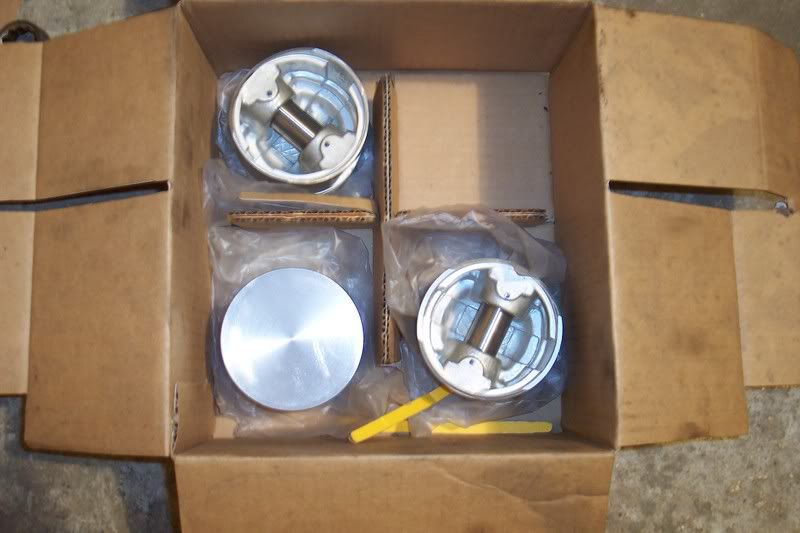

With standard pistons interference *may* be an issue on the inlet valves. When I had my own custom 10.5:1 pistons made, I spec'd a greater valve depth than standard, and even with the bigger cams I had ground I had almost .250" (6.35 mm) of valve clearance when I mock-assembled the engine. I could easily have used the larger cams I spoke of previously. The lift really isn't the clearance issue, it's the duration and lobe separation (e.g., the overlap).
