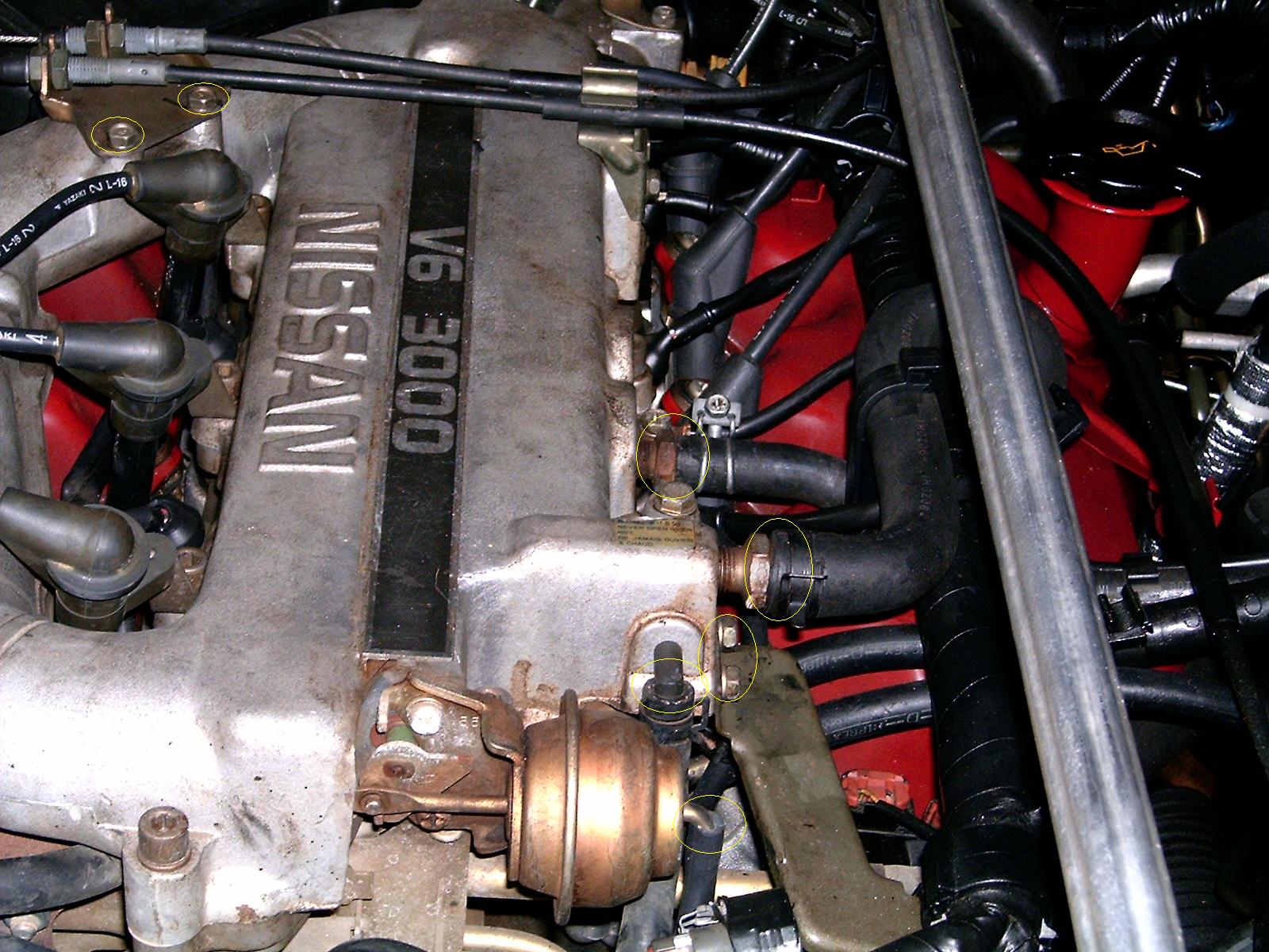

See the bolt that is on the top on the intake manifold in the pic (look towards the lower right near a bunch of hose connections)? It's the small bolt next to the sticker that reads NEVER OPEN WHEN HOT. That is your air bleeder bolt.

Your are awesome!! Thanks for your help. I'm going to try this tomorrow. Just to make sure, I attached a pic with a red arrow pointing at what I think the bleeder is. Do I have to take it right out or just loosen it?
I'm excited to see if this works!!! BTW, what are the other circles for?

The red arrow is indeed pointing at the bleeder. Take it completely off. It's not a very long bolt.
