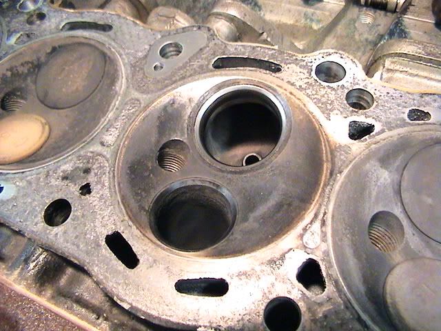

Guys,
I have the big valve 15M head from the Motorsport catalog in the USA. Like I said earlier in this thread, I bought three of these brand new about 10 years ago from Nissan. I sold two and am using the last oneon my full race E16. Unfortunately, after 10 years of racing, it broke a rod last week but did not hurt the head at all [luckily]. But it did slightly bend the intake and exhaust valves on one cylinder. I was smart enough to order an extra set of the larger 13202-63A00 31mm ex. valves as spares, [because with an E-series engine if you have a problem with bent valves, it usually always the ex side that gets it]. But I did not forsee a rod failure and a bent intake valve!
So, does anyone here have an extra 13201-15M00 37mm Intake valve for an E15ET Pulsar turbo or 15M F.I. head to sell me? Help! :(
33 Posts
Oh man, that's not good to hear. Hope you find one. Guess maybe I should have bought that thing a couple months ago when we talked... :waving: Just wasn't to be I guess. Loren
Sentra Specialist
1,902 Posts
Discussion Starter · #77 · (Edited)
Loren,
Good to hear from you. I'm glad I didn't break the car up and sell all of the good stuff now. The car club I belong to just started a new euro-rallycross series and I will be using the car regularly again.
Great news, although there is a mark on it where the piston touched it, the 37mm Motorsport intake valve is not bent after all. I checked it with a dial indicator today. Very lucky indeed. So there was only one slightly bent exhaust valve and I have four spares. Dodged a bullet there. :)
