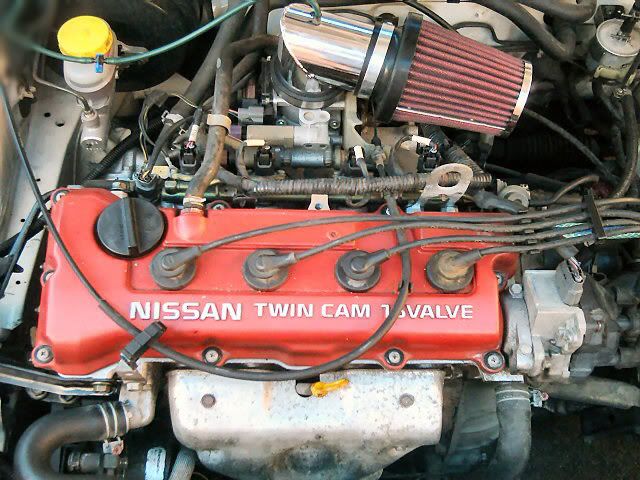

I know you are not very familiar with the GA14 motor - I have one of these in my car - it started out as a 88Hp engine and after some mods (Intake system, headers, freeflow exhaust, 272 degree cams, Unichip and rev limiter override) I have managed to work it up to 116Hp.
Now I will be lifitng the compression ratio on the engine from 9.5:1 to 10.1:1 and I also want to use Individual Throttle bodies. Does anyone know where I can get Individual Throttle Bodies for the GA16? This should be useable for the GA14 as it is the same bottom end and basically the same head - just the stroke and piston size that vary.
All I need to do is manufacture some 40mm trumpets for the ITB's and they should work 100%
I would really appreciate it if someone can help me in this regard.

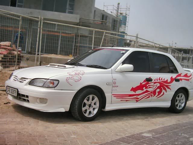

Here is a pic or 2 of the car and engine... (I have not seen this shape of Nissan Sentra anywhere other than in South Africa)
Still before the headers were done - the thin green line leading to the intake manifold is water/methanol injection to curb detonation when advancing the timing)

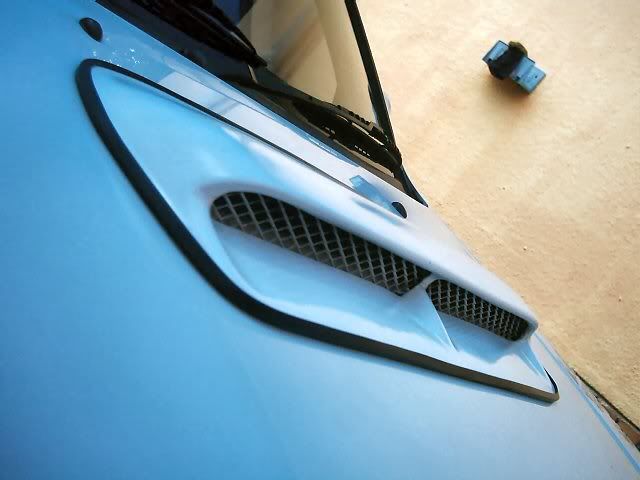

The bonnet scoop was done by myself to get more cold air to the Intake and aftermarket air filter - works like a charm!
Close-up of the scoop....

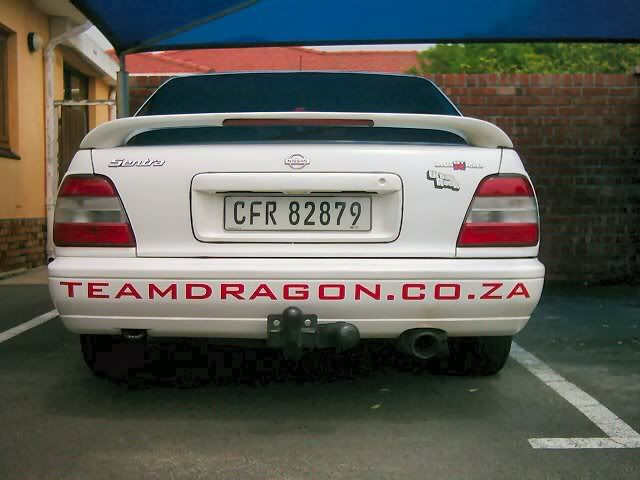

The rear of the car...

as far as I've found, there are no individual throttle bodies available for the GA, any form.
however I think there are other modifications you can do that will benefit your car better than ITBs. A good way to do so is simply tuning it well with the modifications you have. Use the unichip and get on a dynamometer with a wideband O2 sensor and have a professional tune the air/fuel ratios properly.
Also, simple intake manifold massaging or cylinder head porting and polishing to complement the raised compression and other mods can help you out.......but I wouldn't expect a whole lot more out of that engine, it's simply not a big naturally aspirated performer.

Sorry to ask but what's that thing on the back bumper?
It looks like a hitch ball.
But Chim's right, do a head port/polish, raise the compression more than 10:1, maybe get a crankshaft and pistons/rods from a GA16 to raise displacement.
You have to really be breathing heavy to justify ITBs. The upside to ITBs is that A/F ratio is more even and some cylinders aren't running richer than others due to poor manifold design. The downside is that unless the cylinders are pulling hard enough to suck that much air, you'll experience lag of the line.
As far as ITB's, you'll have to get it custom fabricated. I've seen 4AG guys (notorious cheapskates) use motorcycle TBs. The electronics/wiring might be a daunting task as well.

dam bro your car looks bad ass even dough i'm not a big fan of the decals nice ga :thumbup:

Oh - yeah - its a hitch rail at the back of the car - as I race in the streetcar series our cars has to bee 100% roadgoing and legal - the hitch-rail actually extends behind the back of the bumper - just in case someone nudges me from behind on the racetrack... They will be in for a nasy surprise :thumbup:

The intake tube for the K&N filter is a 90 bend. Your loosing alot of flow there, and also creating intake turbulence which slows the natural tuning of the intake to the head. I would says a good 15hp at the top end you would gain by smoothing that part out.
Not 15 hp, maybe a couple.
Hi - As stated above I have tried various arms - even mounting the filter directly in the TB - rounded arms and various angles - but for some or other wierd reason (suppose its to do with the turbulance) this is really the pipe that gives the best results....
· Think outside "The Box"
