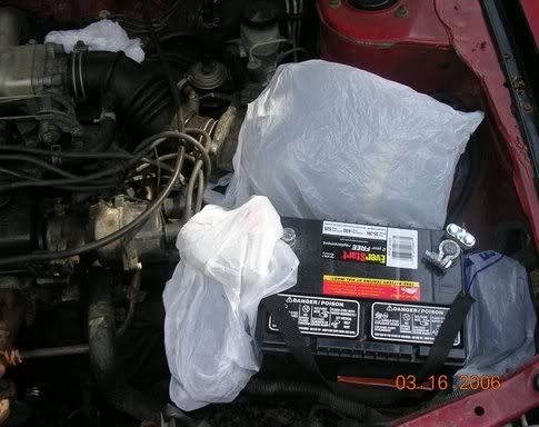

109 Posts
JRinke I finally got ballzy enough to do it today. I cleaned my bay out n' it started up afterwards. Here are my pics of what I covered, if I should have covered something else, someone please state it. I'd like to be safer next time if I should be.
The two fuse boxes, disconnected positive battery terminal (covered whole thing), intake box, and alternater. I was pretty happy with the outcome, I didn't get the hood too well cause I forgot to do it until last and I had run outa mean green. DON"T FORGET UNDER THE HOOD! Lots of crap under there.
