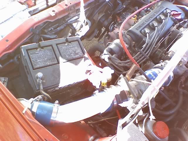

this is my custom intake system i made out of 2.5'' turbo piping and silicone tubing connectors, i didnt use any specific bends just cut my bends out of 90 degree elbows and the only modding i had to do was to the stock metal flange on the maf sensor (just bend it out and cut the section that gets too warped)
here are some pics

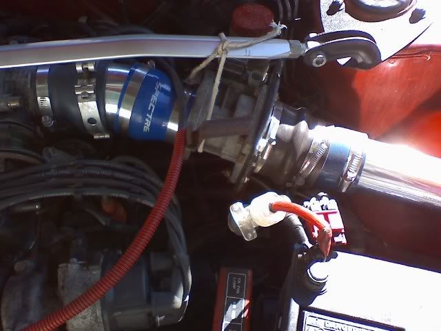

MAF sensor

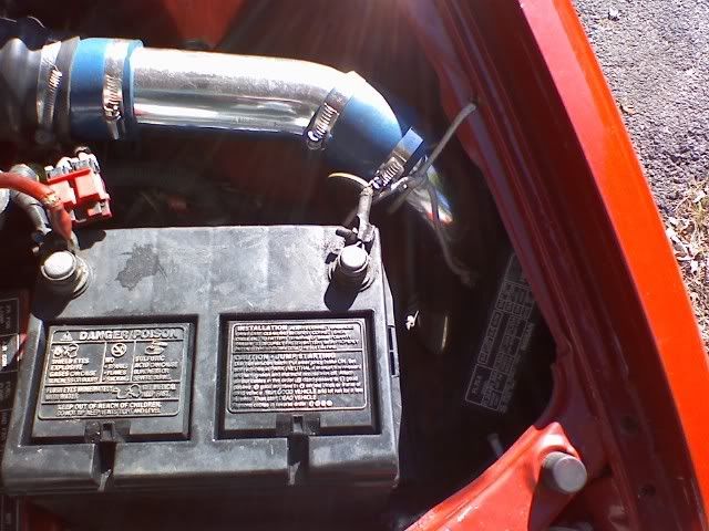

bend down to the fender

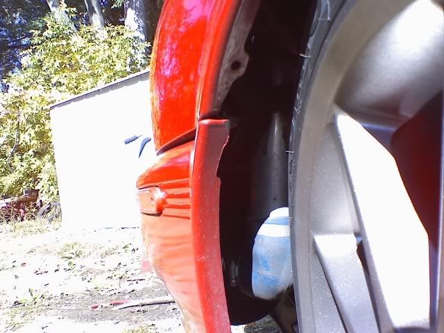

in the fender (90 degree bend toward the front of the bumper)

the only problem i see with that is your filter is not protected from road trash (dirt, water, etc.) i take it you didnt have room to keep the splash guard on?
147 Posts
i havent had time to put it on, it will fit and my water bypass valve is on the way and im gonna put a waterproof pre-filter sleeve on it

good idea.........i need to order a waterproof sleeve also.
99 Posts
that how i had mine but i didnt have to tie it to my strut bar anymore but i have to do something causes i do hear it vibrating..... and you guys mention about a water bypass....um unlucky me it started to RAIN HARD and i hit puddle so hard i dont know if it was the force of water slowing down my car or water going into the filter ....or combination of both lol...but yea please tell me more about this water by pass think gonna need it...tommrow i am going to fix it to prevent as much water i can from getting in there...
