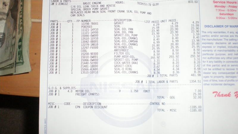

Well well well!!! I’m pissed!! I took my 98 Pathfinder in to Nissan for a quick evaluation after noticing the leak in pic number 1. After talking to the service guy at Nissan, he said it's a possible crank case seal or a cam seal, so he told me that they’d have to pull it apart to resolve the issue and I might as well get the belts,wp,alt belt, etc.. done. OK, sound good I’m due for that anyhow. I go pick up my car 7 hrs later and the service guy say, “good news it was the upper cam seal leaking” cool. $750 and I get my car; I go straight home and park the car. The next morning the car is dripping from the SAME place before they changed the belts in pic 2, plus 2 new leaks in pic 1. ;( WTF
My big question is:
What are my rights as a consumer? And what sould I say whenI revisit them this morning?
Pic1:
Newly created leak after timing belt change at Nissan
Pic 2:
Previous leaks before belt change and still leaking after belt change ;(
I look forward to keeping you all updated.

While the second pic definately looks like a front cam seal was leaking (or one of the front seals, at least), the first pic looks more like the rear main seal or it's retainer gasket/sealant is leaking, a fairly common issue on VG-engines. You could have two seperate leaks...

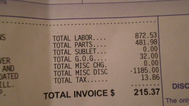

I dropped my pathfinder off yesterday and received a call todya with them expalining that they mis diagnosed it and it is the oil pump that is bad, so they will do the entire job and only charge me for the part which is $175. Its normally a 9 hr job! wow! They mentioned they should have caught it while they were in the changing the belts and seals.

Just so you know, by law, you shouldn't have to pay them a damned cent more - if you brought it with an oil leak, and they said it'll be $X to fix it, then, they have to fix it for X dollars, not X plus whatever they figure out about their misdiagnosis later. As a practical matter, paying $175 may be worth getting the thing fixed rather than haggling endlessly - but - legally you don't owe them a cent more - but then - you seem to have already agreed to pay them, so, I guess you're stuck with it.
It would be nice to learn of a dealer sticking to its obligations once in a while rather than trying to shift the burden of their error to you, even partially.

I would definitely pay them $175 to change the oil pump. That's an all-day job and not an easy one.

I got a call today hoping I could pick up the patty, but it will remain hospitalized. They discovered that the rear main seal is bad along with the pump, so they will be taking care of that as well. They also mentioned that there will be no charge for that; only the price of the oil pump. ;)

Wow, they have to take the trans/t-case off to do that. That's a lot of work for free. You're SURE it's free? Wow again.

I got a call from the service mgr thinking I could go pick up my pathfinder, but not a chance. Apparently, the new oil pump they put in isn’t creating pressure/pumping oil, so they will pull it apart again and replace the pump once more. He mentioned that this isn’t a common issue, but they’ve seen a previous case where this has happened He did assure me that this entire project will only cost me $175 (pump price).

OK, I called today to check the status and to make a long story short, everything is back together. The oil pump is pumping and creating pressure, etc.., but after they test drove it they noticed a small oil leak from the oil pan area. He said, "this should be rather easy by dropping the oil pan and replacing the gasket" I may have it back by today:woowoo:
