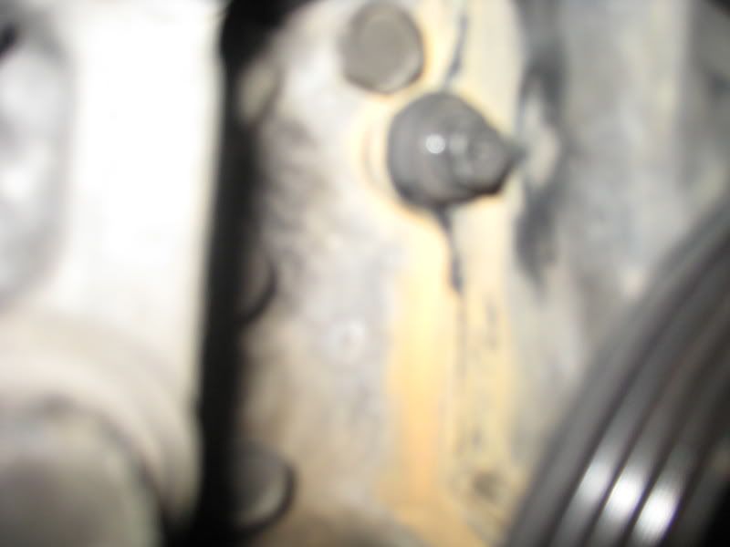

my ALT belt was a totally different story, so i just had it replaced...the 855 size belt wasnt available so i used an 850...it fits
here a pic of were to loosen for the alt
the screw thats going horizontally is for tension...dont need to worry till reassembly
