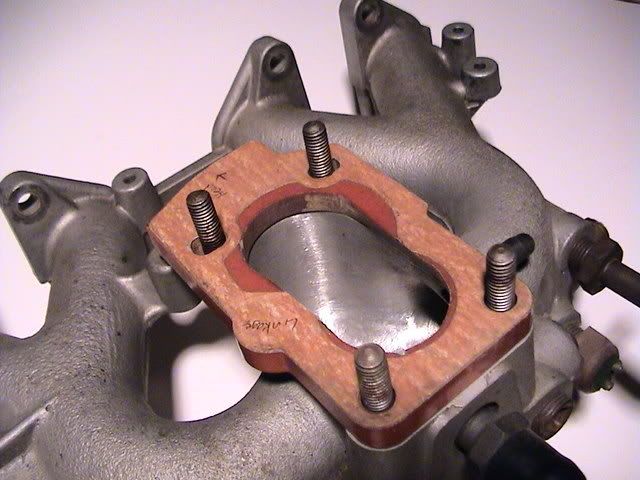

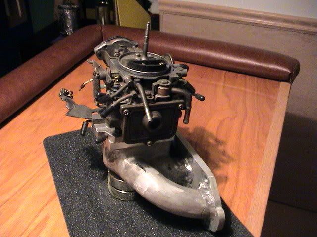

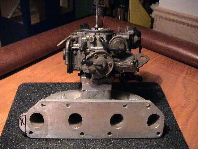

As we all know by now, it is not possible to edit old posts on these forums. That's very disappointing, but there it is. So I wanted to repost a few pics that got lost many pages ago on this thread. Back on page 3 of this thread [post 35 to be exact] here some pics that were lost years ago. I've also reposted the captions as they appeared on that post.
This series of pictures, shows the modified '83 intake, opened up with a die grinder, to accept an '85 Nissan [720] Pickup truck carb, from a Z24 engine.
You can see how much bigger the Z24 carb is, compared to the standard E16's. The orange baseplate gasket is from the Z24. The mounting holes were close enough, to oval out, to fit the E16's carb studs.

Of course in racing you always crave more power. So I figured the stock intake might be holding me back. [This was before I bought the twin side drafts for the race car which are by far the best for power]. The idea was to make a manifold that had four individual runners from the plenum. If you look at the stock E-series intake you will see that each pair of cylinders draws from a single runner off of the plenum. So I searched different manifold catalogs looking for something that had similar intake port spacing to the E16. I found that the old Pinto 1.6 manifolds were really close. So I sourced an early Pinto intake and sawed off the Ford flange. I then traced an E16 intake gasket and machined out an aluminum flange. I then heli-arced it all together and ended up with this custom E16 manifold.
How did this manifold work out? Not very well to be honest. It was an experiment that failed to make any more power. It turned exactly the same speed [at the drags] as with the stock intake. I think that the intake runner length was likely too short, but that's just a guess.

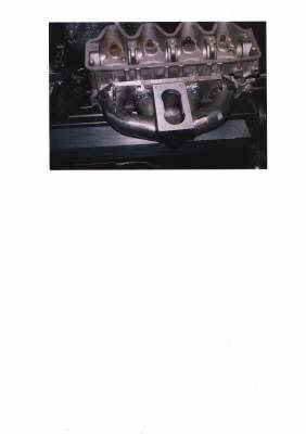

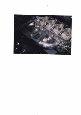

32 Posts
Or is there anybody out there that has one, who could possibly make a replica, or post the bend angles and lengths?
Ok everyone I posted in the e16s header thread but I will do so here also because this is the sticky. I bought the header in 2003, shortly after in 2004 it was discontinued. As far as I know I have the only one left.
[/QUOTE]
