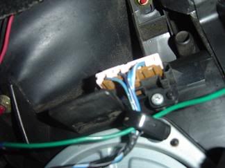

i had this problem and didnt know what to think but if your car does this then chances are its the blower resistor. it is located under the passenger side dash next to the blower motor, there are about 4 wires going into it and its a little clip, has 2 phillips screws holding in place. i believe allot of the same year 91-94 nissans have the same setup.the number 4 settin sends the full current to the blower while the resistor regulates the current for lower speeds, dealership cost was 25 after taxes. hope this helps someone. i know it was posted on ser.net i believe but i just wanted to share the info for peeps that search this site

That's interesting. There is one wire from the fan switch which goes directly to the blower motor and circumvents the resistor. If all your other settings work, that means this wire is broken somewhere. Check its connection from the fan switch to the motor using a multimeter. If you can't locate the break, you could install a new wire from the switch (position 4) to the motor and then tuck it up into the dash, nice and neat. PM me if you have any more specific questions.
