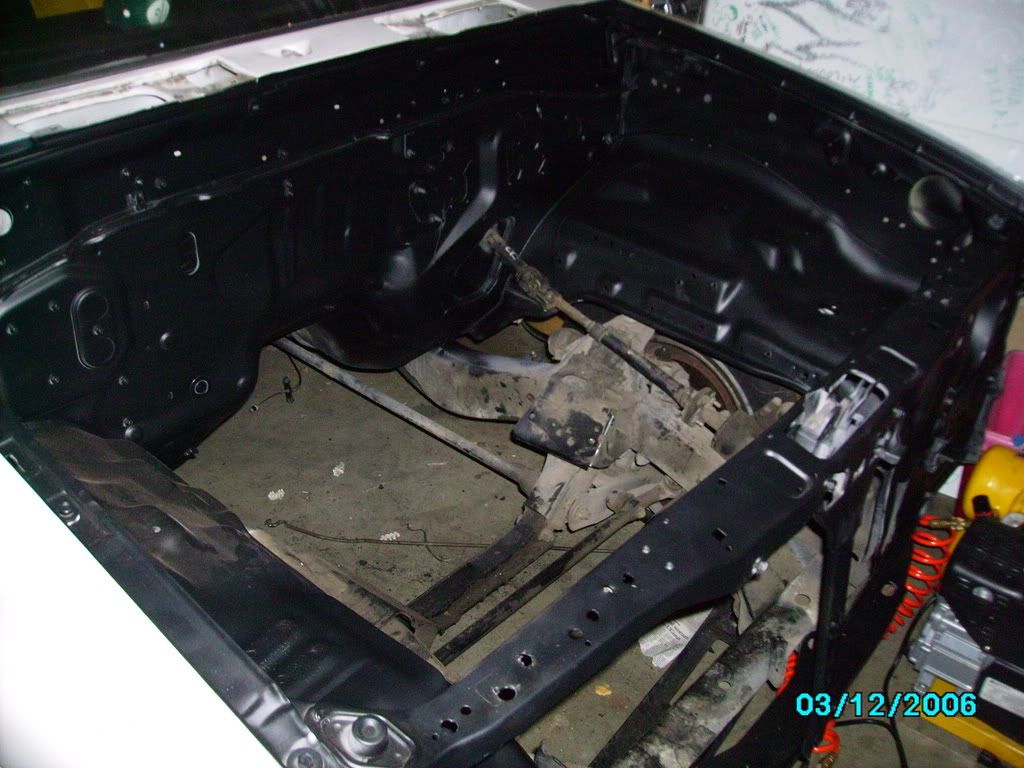

-The start of the project: deconstruction!!
-Here's my handiwork with a Scotch-Brite pad and about three cans of engine enamel

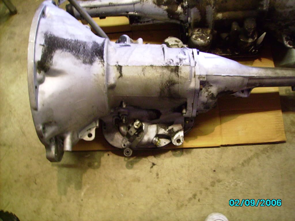

-And here's that 904 automatic ready for installation

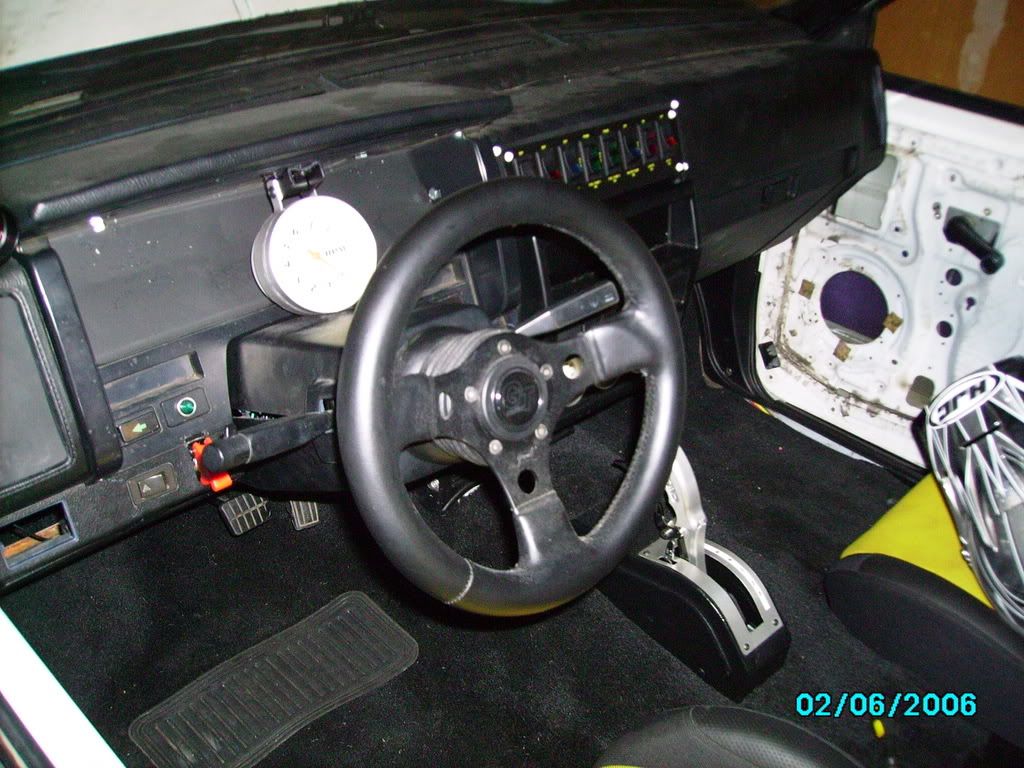

-This is the interior currently. Nothing but business. The switches control the ignition, fuel pumps, water pump, fan, etc. Aside from the big tach, there are three gauges (water temp, volts, and oil press) where the radio used to be. The hurst shifter is a nice touch too ;)
