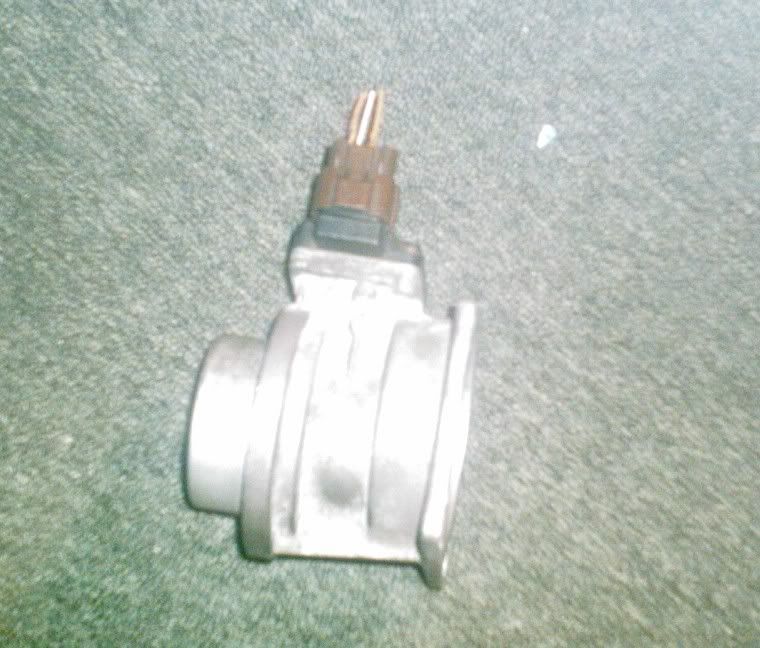

hey mike, nice project you did here, i love how u did everything within the budget (2k) very nice indeed, it's a shocker to me cause i am planning on getting that turbo setup for my car, n i was a bit confuse on the fuel system management, u really clear my head about it. I decided to follow ur foot steps on this, I am new to this so please bare with me :)newbie:) I bought the stock se-r injectors and se-r maf, the se-r ecu is currently being tuned for my 93 ga16. first question. this question could make me look stupid but hell the se-r maf sensor has a different socket from my ga maf wire, did u made the ga wire fit without cutting it? if not, i have the wires for the se-r's, but if i were to cut i don't know which wire goes to which on the ga wire :confused:
9 Posts
-_- wasted money on this maf, this apparently wasn't for a b13 sigh:mad: anywho, i got the right one that fits right in. i am going to dedicate myself on this turbo kit, i am going to try to squeeze w.e hp it could give me on this car with mike's setup.
