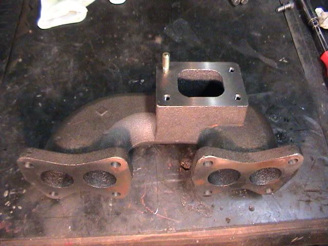

This shows the plenum roof of the cast turbo manifold. A small flow directing wedge helps guide exhaust gases to the turbine.

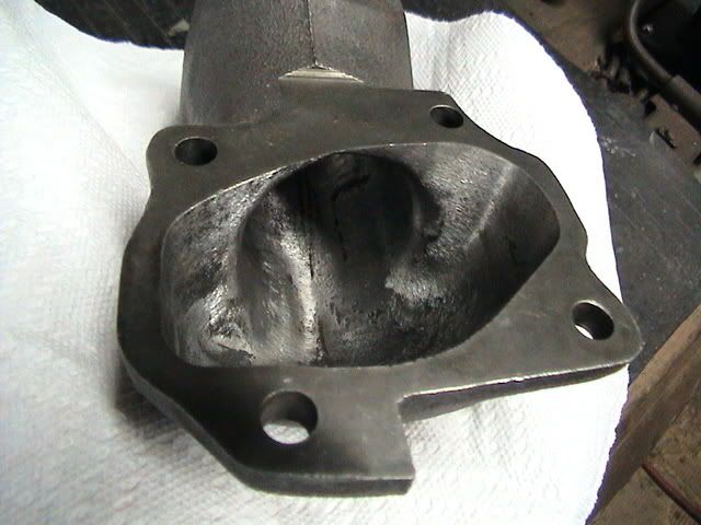

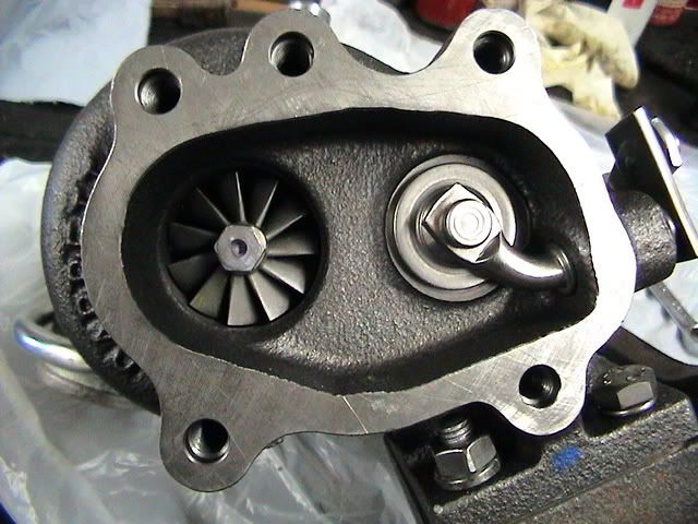

I opted to port match the exhaust elbow to the turbo's chamber for best flow characteristcs. In this picture you can faintly see the areas where I used a black marker to show where I had to remove material to match the turbo outlet [below].

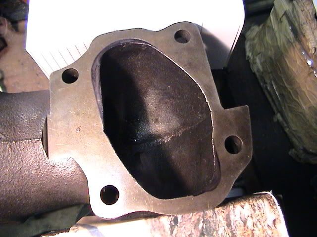

This is how it looked afterwards.

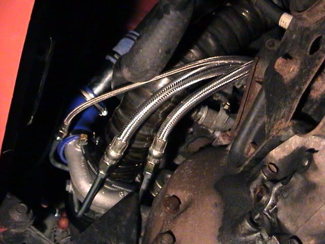

Oil pressure and coolant lines connected. At Wes' suggestion, I teed the turbo cooling lines into the factory GA throttle valve cooling hoses. It was simple and it worked out very nicely. I had to flip the lower radiator upside down to clear the flexible turbo intake pipe.

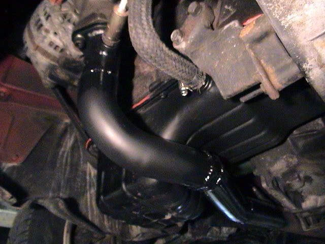

I modified the supplied 2" downpipe to mate to my existing 2" mandrel bent system.

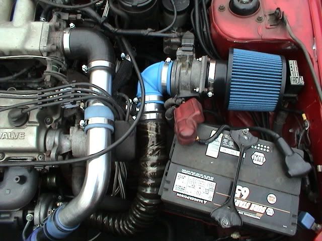

I sourced the 3" MAF adapter and cone filter on ebay. Cost: $18.95 shipped.

I just looked at the install pics. again and I did not remember seeing them. Few points of interest to me.
The manifold appears to be pretty good. How far down is it before the cylinders meet or pair? I think that manifold could be quite good with an extrude hone thrown on it actually. (not that there is anything wrong with it now...) I would like to see someone use that manifold on a larger T2 series turbo and bust out a high HP setup on a budget. I think it can be done on the cheap!
