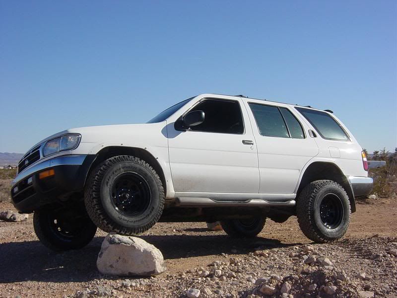

Here's a pic of 31s on 15s on my '97 without a lift. I'll get pics of the parts I had to trim, later on. Hope this helps.
