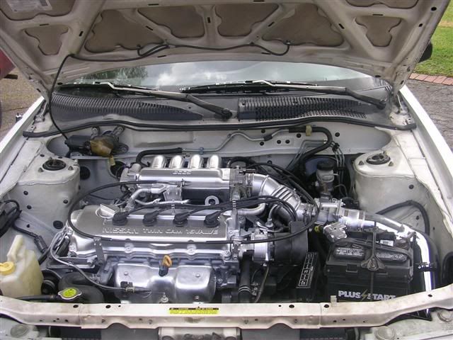

Thanks for the concern JRinke, but my car runs great. I didn't want to show these pictures because I didn't want to reveal what I've done to the car so far!!! =D But while we are at it...here is a preview so far! Before and after pics:
Before:
After:
