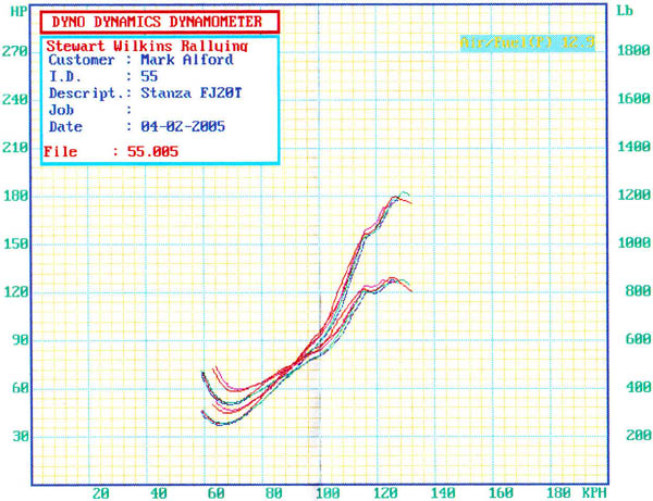

Dyno Report
Hey guys, just had the car on the Dyno yesterday, and I have placed a copy of the printout below.
We made 183rwhp at a little over 6,000rpm running 15psi boost. Torque was 850lb...so plenty there. I was hoping for 200, but we didn't quite get there.
If you look at the graph you can see the car was making good power all the way to the 6,00rpm point....then it hits a wall.....this wall is the stupid restrictor we have to run in our category. The combination of big camshafts and big turbo simply do not work with the restrictor. After I have taken it to the track a couple of times, We will pull the head and place factory spec camshafts back in the car with the appropriate valve springs. Also, we will source another turbo with the right specs for our application. Afterthis is done, I will also add a water injection system so that we can advance the timing another 5 degrees...this alone should give us 20hp.
We are aiming to make full boost at 2,500 revs with a usable torque curve from 2,000 through to 6,000 rpm. The goal is 240rwhp and over 1,000lb's of torque....we know we can't make much more than that with the restrictor in place.....I'll let you all know how we get on.
Notice the slight dip in the power curve 3/4 of the way up.....that's where the cams really started to work, just under 5,000rpm. Combined with the boost, the car really sat up on the dyno....they ended up strapping it down to make sure it didn't climb off the dyno.
