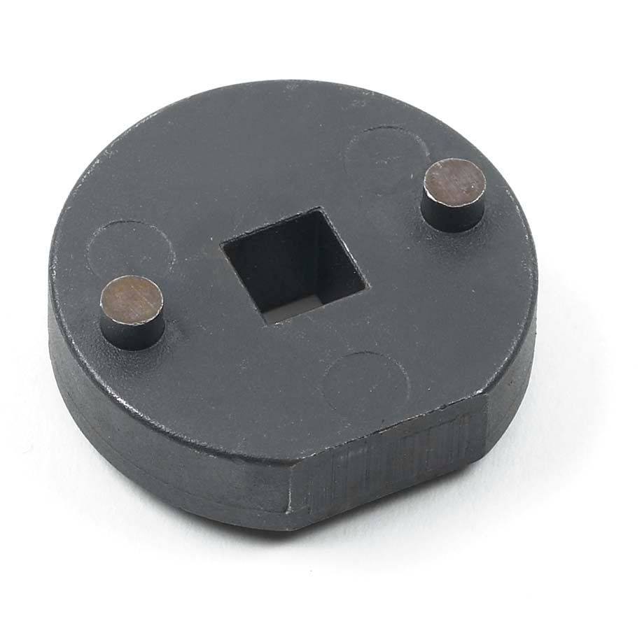

no, don't bleed brake lines. should not be necessary. if you still haven't bought the pads, ask the parts store if the have loaner tool for rear brake pistons. looks something like this:
- or this -
"...and the Lord said to John, Come forth and ye shall receive eternal life, but instead John came fifth and won a toaster."
